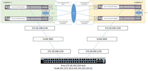

Have a OSPF issue that I must be missing something obvious. Basically I have some EXOS devices activing as the core OSPF backbone area. At the edge I am using a EOS C5 switch configured as an OSPF Stub area.
The two have created a neighbourship between them, and I can see this in the LSDB tables.
The problem is I can't see the routes from the edge showing up on the core. This is the one I'm interested in at the moment:
172.20.0.254 255.255.255.0
Here is a quick diagram:
Here is the OSPF config on Core 1 (only one connected at the moment), the points of interest are via the P2P VLAN "OSPF-Col-BSD-CEF" and area 172.20.192.254 :

Here is the config on the edge (only configured interface VLAN 101 for now for OSPF, as well as the P2P's):

The routing table on EOS shows the VLAN 101 and the P2P VLAN 2001 are up:
Col-BSD(su)->router#show ip route
Codes: C - connected, S - static, R - RIP, O - OSPF, IA - OSPF interarea
N1 - OSPF NSSA external type 1, N2 - OSPF NSSA external type 2
E1 - OSPF external type 1, E2 - OSPF external type 2
E - EGP, i - IS-IS, L1 - IS-IS level-1, LS - IS-IS level-2
* - candidate default, U - per user static route
C 172.20.0.0/24 [0/1] directly connected, Vlan 101
C 172.20.192.192/26 [0/1] directly connected, Vlan 999
C 172.20.248.0/30 [0/1] directly connected, Vlan 2001
Col-BSD(su)->router#show ip ospf interface
Vlan 101
Internet Address 172.20.0.254 Mask 255.255.255.0, Area 172.20.192.254
Router ID 172.20.192.254, Cost: 10 (computed)
Transmit Delay is 1 sec, State designated-router, Priority 1
Designated Router id 172.20.192.254, Interface Addr 172.20.0.254
Backup Designated Router id 0.0.0.0,
Timer intervals configured, Hello 10, Dead 40, Retransmit 5
Vlan 2001
Internet Address 172.20.248.1 Mask 255.255.255.252, Area 172.20.192.254
Designated Router id 172.20.192.254, Interface Addr 172.20.248.1
Backup Designated Router id 172.20.207.62,
Vlan 3001
Internet Address 172.20.249.1 Mask 255.255.255.252, Area 172.20.192.254
Transmit Delay is 1 sec, State Err, Priority 1
Designated Router id Err, Interface Addr 172.20.249.1
Backup Designated Router id Err,
Routing table on EXOS, but its not showing the subnet 172.20.0.254 255.255.255.0 via OSPF-Col-BSD-CEF:
Col-Core1.68 # show iproute
Ori Destination Gateway Mtr Flags VLAN Duration
#d 172.20.207.0/26 172.20.207.62 1 U------um--f- Mgmt-CEF-Core1 0d:2h:3m:4s
#oa 172.20.207.64/26 172.20.251.242 11 UG-D---um--f- Core1-To-Core2 0d:1h:13m:56s
#oa 172.20.207.128/26 172.20.250.243 12 UG-D---um--f- Cores-To-Cores 0d:1h:13m:52s
#oa 172.20.207.192/26 172.20.250.243 13 UG-D---um--f- Cores-To-Cores 0d:1h:13m:52s
#d 172.20.248.0/30 172.20.248.2 1 U------um--f- OSPF-Col-BSD-CEF 0d:1h:42m:33s
#d 172.20.250.224/30 172.20.250.225 1 U------um--f- Core1CEF-LgcyCEF 0d:2h:3m:4s
#oa 172.20.250.228/30 172.20.251.242 11 UG-D---um--f- Core1-To-Core2 0d:1h:13m:56s
#oa 172.20.250.232/30 172.20.250.243 12 UG-D---um--f- Cores-To-Cores 0d:1h:13m:52s
#oa 172.20.250.236/30 172.20.250.243 13 UG-D---um--f- Cores-To-Cores 0d:1h:13m:52s
#d 172.20.250.240/29 172.20.250.241 1 U------um--f- Cores-To-Cores 0d:2h:3m:4s
#d 172.20.251.240/30 172.20.251.241 1 U------um--f- Core1-To-Core2 0d:2h:3m:4s
#oa 172.20.251.244/30 172.20.250.243 3 UG-D---um--f- Cores-To-Cores 0d:1h:13m:52s
#d 172.20.251.252/30 172.20.251.253 1 U------um--f- MLAG-ISC 0d:2h:3m:4s
OSPF Database on EOS:
Col-BSD(su)->router#show ip ospf database
OSPF Router with ID(172.20.192.254)
Displaying Router Link States(Area 172.20.192.254)
LinkID ADV Router Age Seq# Checksum
172.20.192.254 172.20.192.254 117 0x80000009 0x37bb
172.20.207.62 172.20.207.62 826 0x80000005 0xc0e8
Displaying Net Link States(Area 172.20.192.254)
172.20.248.1 172.20.192.254 827 0x80000003 0x8c46
Displaying Ipnet Sum Link States(Area 172.20.192.254)
0.0.0.0 172.20.207.62 118 0x80000009 0x777
OSPF LSDB on EXOS:
Col-Core1.68 # show ospf lsdb
Router LSAs for area 0.0.0.0
Link State ID Adv Router Seq# Age Chksum #Links
172.20.207.62 172.20.207.62 0x80000006 914 0xf1b5 5
172.20.207.126 172.20.207.126 0x8000000a 931 0x2da0 5
172.20.207.190 172.20.207.190 0x8000000c 929 0xeda0 5
172.20.207.254 172.20.207.254 0x80000009 178 0x 6b6 5
Network LSAs for area 0.0.0.0
172.20.250.243 172.20.207.190 0x80000003 929 0xd070
Summary LSAs for area 0.0.0.0
172.20.248.0 172.20.207.62 0x80000003 944 0x3e93
Router LSAs for area 172.20.192.254
172.20.192.254 172.20.192.254 0x80000009 238 0x37bb 2
172.20.207.62 172.20.207.62 0x80000005 945 0xc0e8 2
Network LSAs for area 172.20.192.254
172.20.248.1 172.20.192.254 0x80000003 948 0x8c46
Summary LSAs for area 172.20.192.254
OSPF Neighbour EXOS:
Col-Core1.69 # show ospf neighbor
Neighbor ID Pri State Up/Dead Time Address Interface
BFD Session State
172.20.207.126 0 FULL /DROTHER 00:01:23:02/00:00:00:02 172.20.251.242 Core1-To-
None
172.20.207.190 120 FULL /DR 00:01:23:00/00:00:00:10 172.20.250.243 Cores-To-
None
172.20.192.254 1 FULL /DR 00:01:23:00/00:00:00:00 172.20.248.1 OSPF-Col-
None
Total number of neighbors: 3 (All neighbors in Full state)
OSPF Neighbour EOS:
Col-BSD(su)->router#show ip ospf neighbor
ID Pri State Dead-Int Address Interface
172.20.207.62 10 Full 40 172.20.248.2 vlan2001
Col-Core1.3 # show version
Switch : 800770-00-04 1746N-40857 Rev 4.0 IMG: 22.3.1.4
Image : ExtremeXOS version 22.3.1.4 22.3.1.4-patch1-7 by release-manager
on Tue Jan 16 09:05:31 EST 2018
Diagnostics : 2.5
Certified Version : EXOS Linux 3.18.48, FIPS fips-ecp-2.0.16
Col-BSD(su)->show switch
Management Preconfig Plugged-in Switch Code
Switch Status Model ID Model ID Status Version
1 Mgmt Switch C5G124-48P2 C5G124-48P2 OK 06.71.03.0025
2 Stack Member C5G124-48P2 C5G124-48P2 OK 06.71.03.0025
Many thanks in advance.
Vlan 101
Vlan 2001
Vlan 3001
OSPF LSDB on EXOS:
BFD Session State
None
None
None
OSPF Neighbour EOS:
Diagnostics : 2.5
1 REPLY 1
Anonymous
Not applicable
‎05-16-2018 05:06 PM
Figured it out.... the EOS device link-type is set to broadcast by default, whereas I had configured point-to-point on EXOS.
