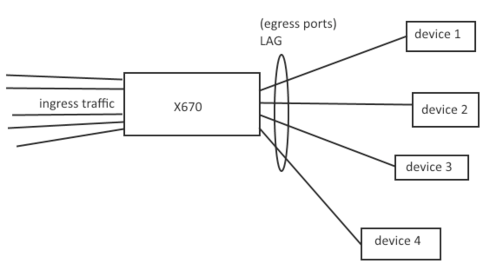

this traffic can be in specific vlan or not.
this traffic mirroring from other device to X670 and I have to transmit this traffic onwards to 4 different monitoring devices.
Thats why I built static LAG (but not lacp) with 4 ports. And this traffic have to go to monitoring device. But 1 device have to receive traffic with the same src-IP/dst-IP. This can done by L3 balancing.
Thats why I can configure VLANs on X670 as I want - the same VLAN, or different vlans.
Scheme like this:
