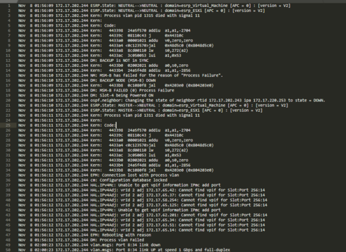

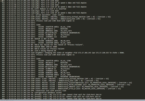

hi EtherMAN
this are the logs that showed us
