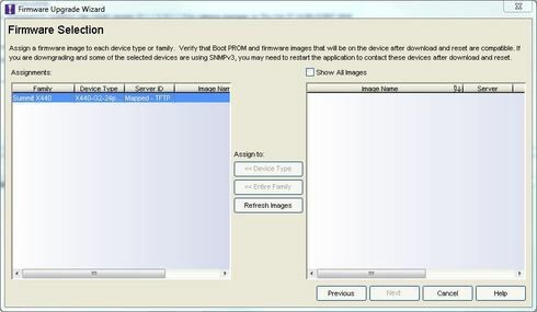

When I use the Firmware Upgrade Wizard in Netsight, I can't do a Frimware Selection.
So I cann't map af device type to an image an upgrade the switch.
I tested a couple devices (X440, X460)
Version Netsight 7.0.9.4

Do you mean this view?
d9221abff2024d89a98f3fb9f3498183_RackMultipart20170206-7530-1370py7-firmware-selection1_inline.jpg
On my side there is no firmware shown automaticaly, but if i check the "Show All Images", there i can choose the firmware i want. And the Update works for Summit Switches.

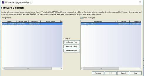

No, I see the firmware but I cann't assign the firmware to the device or family
8150b34e23b94fdc81dd7886ba7465a9_RackMultipart20170224-47457-11vbk48-upgrde_firmware_inline.jpg
e
Johan Hendrik System Architect Audax

I have found most issues having a question mark are fixed by correcting SNMP credentials on either the switch or in Profile/Device Mapping in Netsight.
Steve_Ballantyn
Contributor
I have had this same issue. I deleted the device and then re-added it back to Netsight. And then I was able to upgrade the firmware without any problems. It seems like there have been a few other people with this same problem and deleting/re-adding the device fixed it.
I am thinking there might be a bug hidden away in there somewhere?
