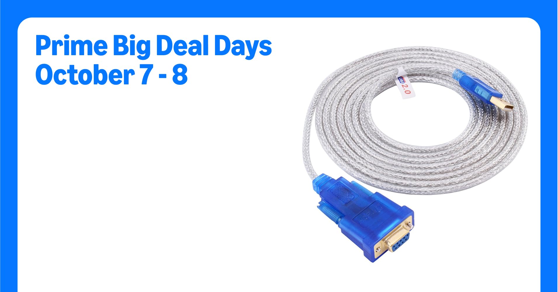

Tried these two cables so far and putty just hangs, hitting enter does nothing:
https://www.amazon.com/dp/B0759HSLP1?psc=1&ref=ppx_yo2ov_dt_b_product_details
This one matches the pinout in the pdf manual (RXD on pin 2, TXD on pin 3)

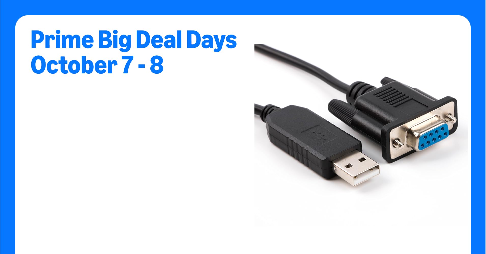

https://www.amazon.com/dp/B078MCCX3C?psc=1&ref=ppx_yo2ov_dt_b_product_details
Null modem cable (maybe not supposed to be crossed wire rollover)
