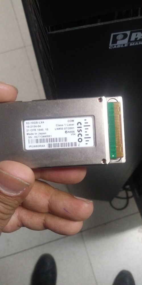

Does cisco XFP (10G LR & LX4) compatible to work with extreme 10G SFP+
‎09-22-2021 07:12 AM
extreme part codes --
10301 | 10 Gigabit Ethernet SFP+ module, 850nm, MMF 26-300m link, LC connector |
10302 | 10 Gigabit Ethernet SFP+ module, 1310nm, SMF 10km link, LC connector |
‎09-22-2021 07:59 AM
connection with X2-10GB-LR & Extreme 10302 is not coming up. we tried with tx/rx swap also we used multiple SM/MM cables.
So I want to know is there any other dependency other than frequency like protocol & standards or signaling rate?
‎09-22-2021 07:31 AM
X2-10GB-LR should be compatible with Extreme 10302.
X2-10GB-LX4 is not compatible with both of them. Afaik this XFP uses CWDM. So you would need a CWDM SFP+ on the other end.
