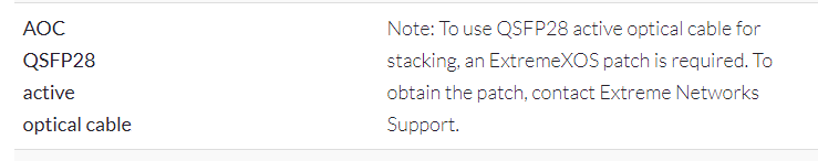

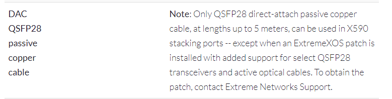

This information is present as comments for different types of switches here - https://www.extremenetworks.com/support/compatibility-matrices/summit-extremeswitching-and-e4g-compo...
Look’s like:
Thank you!
