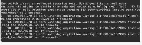

Thanks Stephane. So I created the vm from the iso image and powered it on and it booted successfully. I then followed the install guide to add more nics, but now when I power on the vm it does not boot. I keep getting a watchdog warning message that has seconds that count up each time the error message appears. Note: This conversation was created from a reply on: How to enable MPLS on ExOS VM ?.

I did some more troubleshooting and i figured out what was causing the watchdog error. Adapters 3 and 4 were causing the issue. i created a new VM and disabled each adapter at a time starting with 4, and then i started the VM after disabling the individual adapters. The error went away when the VM booted after adapters 3 and 4 were both disabled. I then added 6 nics/ports and the VM booted without a problem. i hope this helps you narrow down the issue with the VM.

1. I am running the VM in VirtualBox Version 5.0.14 r105127
2. i added 4 more nics

- What platform are you running your VM on?
- How many NICs did you add?
- What's the exact error message?
