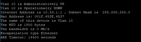

Sorry, the ip segment is 10.33.1.1 of vlan 10

sorry my fault it's "show port status ge.1.2-3" to see whether the port is admin/operational up
we'd need to bring the VLAN interface in operational state up or it will not work

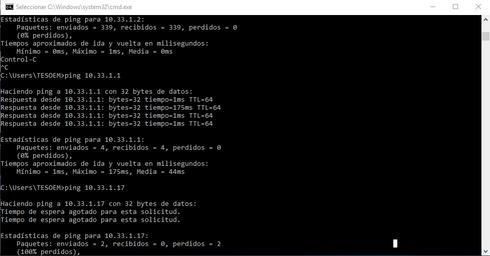

This is the test that is done for the communication between vlan's
