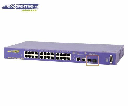

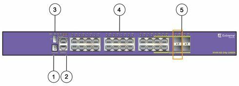

notice: on the summit 200 the uplink ports were 25/26 (grouping)
on the 440-g2 are the uplink ports 21/22 (grouping)
summit 200
x440-g2
on the orange marked ports are / were the lwl cables connected
