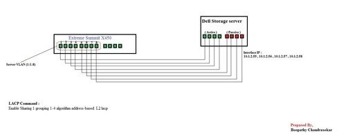

Am facing difficulties while configuring LACP on Summit X450 :-
Command which I used in SW :
enable sharing 1 grouping 1-4 algorithm address-based L2 lacp
My question is , Is that mandatory to configure LACP on my Dell Server ? (If yes, How ? )
After entering the lacp commands, i am getting request timeout on my continuous ping( to server).....
Kindly help me out in this as early as possible !!!!!!

So , Here we are using storage server on other side.
We are still facing challenge while configuring LACP on Storage side..
Because there is no option like LACP or Teaming in the Storage side.!!!
How to fix this scenario ????
Boopaa
New Contributor II
533a2dd15dde4ec2bfed61daaa13c15c_RackMultipart20160329-1463-118v5jc-LACP_Diag_inline.jpg
