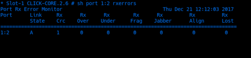

‎12-21-2017 09:12 AM
HI Alok
you can use the below commands to see if there is RX or TX errors
sh port rxerrors port-number
sh port txerrors port-number
for a specific port use like this
sh port 1:2 txerrors
sh port 1:2 rxerrors
