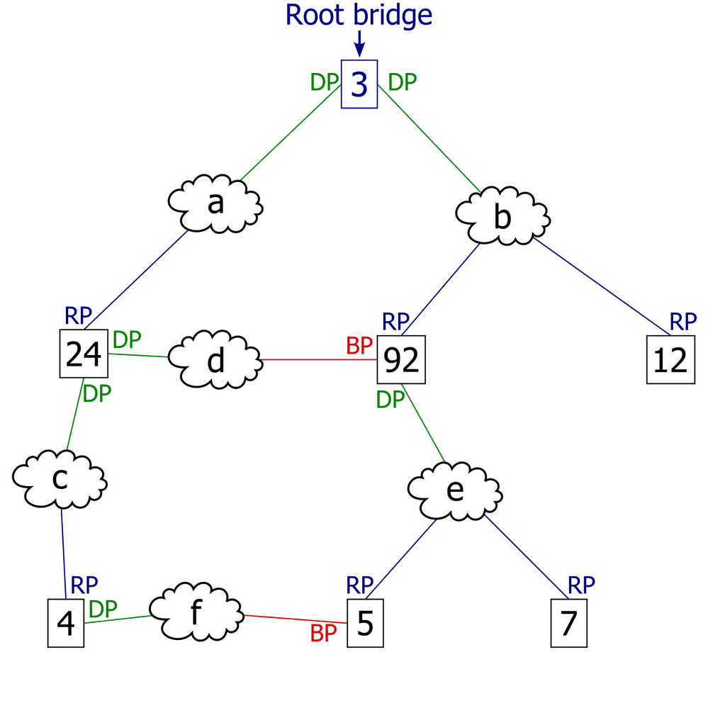

‎08-08-2021 08:19 PM
It depends on your network topology. If you only want a loop protection I would go for ELRP. But some networks structures require some kind of STP, e.g. with multiple edge-switches that have multiple connections between each other, like here:
