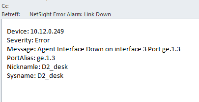

1) I've found this article but it doesn't work with my 6.3 Netsight and a D2 switch.
https://gtacknowledge.extremenetworks.com/articles/How_To/How-to-add-port-name-in-notification-email...
Tried it a view times because of...
"Please note that the alias information for the port will not display the name until the second trap/event comes in. The first time the notification will get sent before the port cache is populated with the name. After that you should get the name."
I've also tried this...
https://gtacknowledge.extremenetworks.com/articles/Solution/NetSight-alarm-notification-is-not-inclu...
2) That works,,,,
- Edit the alarm in question
- Change to the Actions tab.
- Place a check in the Override Content box.
- Click on the Edit Content button
- add either $deviceNickName or $sysName and you'll get the sysname/nickname of the switch in the mail
Example:
01b2f766a2d646fcb5a9c042149bd71f_RackMultipart20151016-29712-65r7kv-Netsight_email_link_down01_inline.png
-Ron
