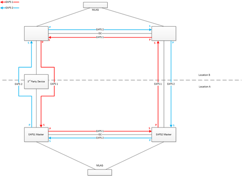

I tested in my Lab, without sucsess.
One Ring is in failed state and the other is "Links-Down".
The Ports on both Switches has primary port in one ring and secondary port in other ring to the 3rd party device (in my lab a D2-Switch) and on the other side the ports for the rings are crosswise to the first...
Is it possible, that end-point "down" is the wrong state in my case...
Here a quick design-map:
4314dac8d67d44e3b6cff5f364599d5c_RackMultipart20160512-37385-1b9wz5t-eaps_mlag_design_inline.png
