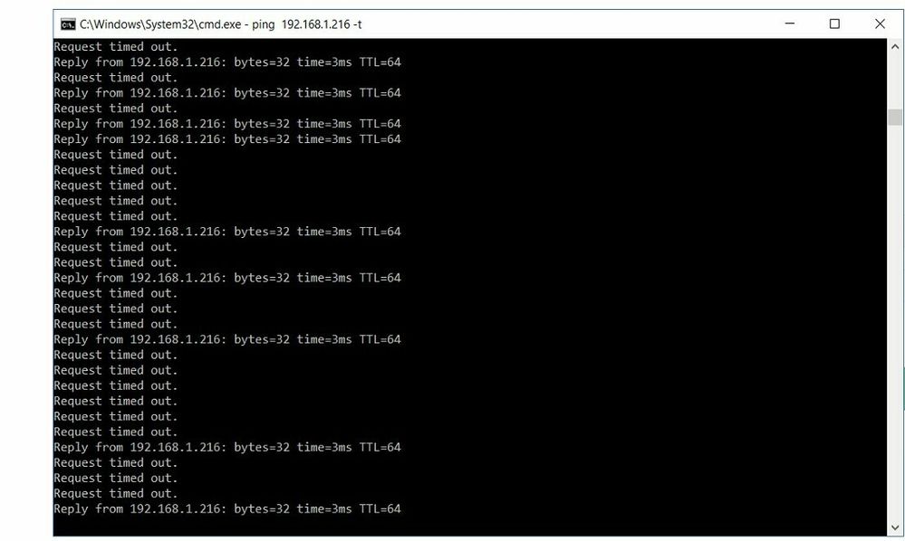

We have a problem whit two switches X440G2-24t-G4, after to connect by port 24 the connection is lost.

‎03-06-2019 02:46 PM
Hi Ronald.
It's the first time we use this switch brand.
We have connected two switches through port 24, as you know they are ethernet ports. Apparently there is conflict between them since we lose connectivity in the network.
The switches have their default configuration (only the VLAN default).
