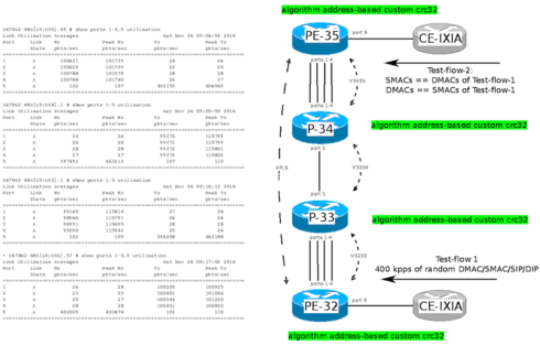

Test 2
Description: single VPLS tunnel with LSP load sharing
In this case packets from test-flows are shared between several LSPs and it makes MPLS labels to be different for the different packets from the same VPLS tunnel:

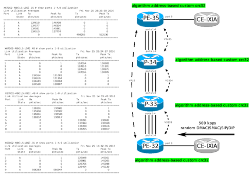

X670G2-48X[L5:U32].14 # show mpls statistics l2vpn
L2VPN Name
Peer IP/LSP Flags RxPackets RxBytes TxPackets TxBytes
VPLS_VPN
10.0.0.35 U 2920 227552 15099705 1298574028
LSP1 + 360 28720 1886864 162270218
LSP2 + 370 29760 1885514 162153946
LSP3 + 342 28200 1885072 162116106
LSP4 + 350 28562 1888660 162424674
LSP5 + 381 27602 1887981 162366366
LSP6 + 372 28002 1887950 162363700
LSP7 + 375 27200 1888686 162426910
LSP8 + 370 29506 1888978 162452108
Here is configuration example for this setup:

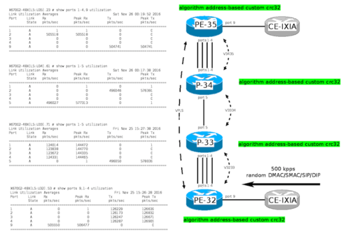

Test 3
Description: single LSP and multiply source ports involved in sharing
In this example sharing algorithm can use information about source ports to better distribute traffic across ports in sharing group.
