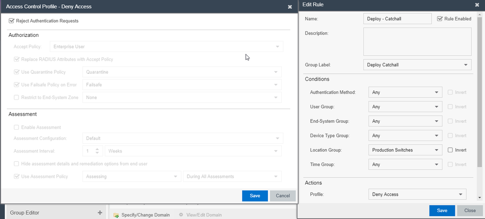

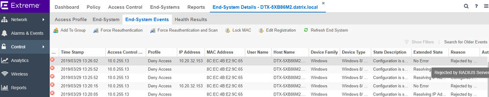

Here is the end-system showing a reject on the XMC / NAC and the policy defining the reject authentication request:
Could it be that the authentication is showing failed rather than rejected. In netlogin session it shows MAC authenticated and the other shows the method 802.1x?
