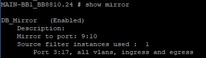

I set up the mirroring, but an unknown log is generated and registered in the actual "show mirror"
After connecting the actual wireshark to port 9:10, the packet will not become a mirror.
If you have a problem like this, can you find a solution?
The commands entered are as follows.
create mirror DB_Mirror
config mirror "DB_Mirror" to port 9:10
config mirror "DB_Mirror" add port 3:17 ingress-and-egress
enable mirror "DB_Mirror"
show mirror
