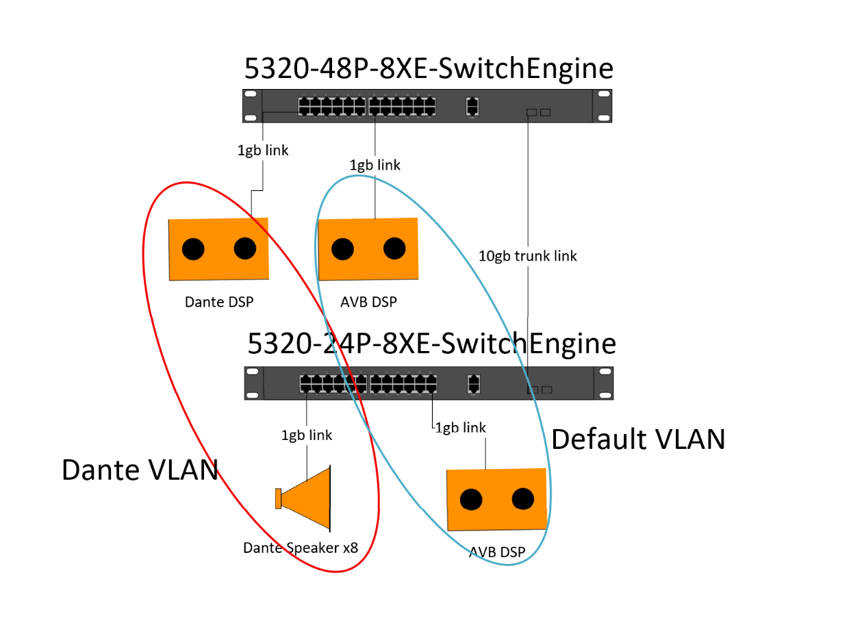

I have several 5320 switches for an AV setup. I have two VLANs set up. First for AVB. Second for Dante.
PTP appears to be working on the 24-port switch, as it selects a device as the master clock. The issue is that the DSP connected to the 48-port switch does not participate in the process and elects itself as the master clock.
Anyone able to assist with this setup?
