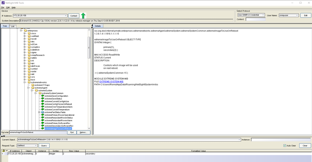

extremeImageToUseOnReboot=1.3.6.1.4.1.1916.1.1.1.15
DESCRIPTION: Controls which image will be used on next reboot.

‎05-09-2019 04:09 PM
Correct.
The XMC MIB browser does a great job providing all details in case you are looking for a specific MIB OID and the integer values....
‎05-09-2019 03:56 PM
Thanks! I tried that before and it was giving me only integer 1 or 2. After testing, 1 means primary and 2 means secondary. ?
