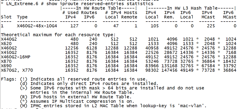

One of our switch core Extreme X460G2 had this problem when adding a new static route, the logs about are:
LN_Extreme.3 # show log
12-Sep-2019 17:46:06 IPv4 route not added to hardware. Reached configured # of IP Route reserved-entries. (Logged at most once per hour.)
12-Sep-2019 17:46:04 [VR 0x00000002] Peer 10.101.1.2 (0) has entered or left Established state, EST? 1, holdtime: 30, passive: 0
12-Sep-2019 15:58:45 vrId 2 dest 200.1.183.152:32 nexthop 10.101.1.162: DEFIP add uninstalled: Entry exists (-8): cannot add - ref 1, ins 0
12-Sep-2019 15:58:45 vrId 131074 dest 200.1.183.152:32 nexthop 10.101.1.162: Unable to add route to unit 0, rc Entry exists. Shadow problem.
12-Sep-2019 15:58:44 [VR 0x00000002] Peer 10.101.1.2 (0) has entered or left Established state, EST? 0, holdtime: 30, passive: 0

I have read this article https://extremeportal.force.com/ExtrArticleDetail?an=000075800 , but I didnt find any problem
Please help me, I think it coud be a bug.
