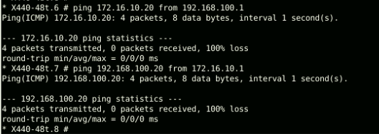

12-15-2020 12:47 PM
Pinging on the switch without a “from” didn’t show if routing is working. Can you do the ping with “from” as descripted.

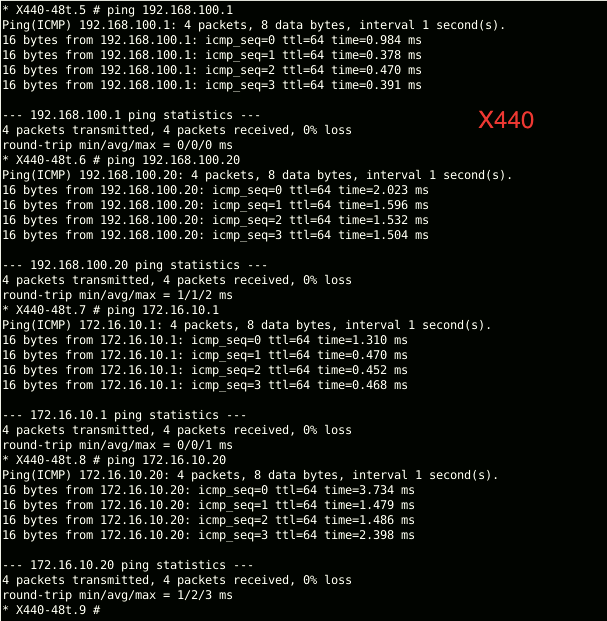

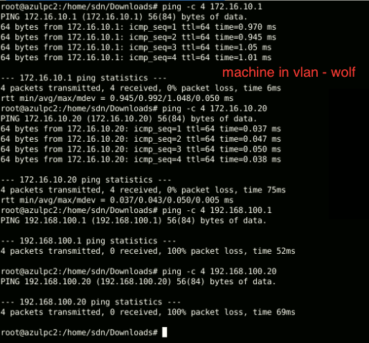

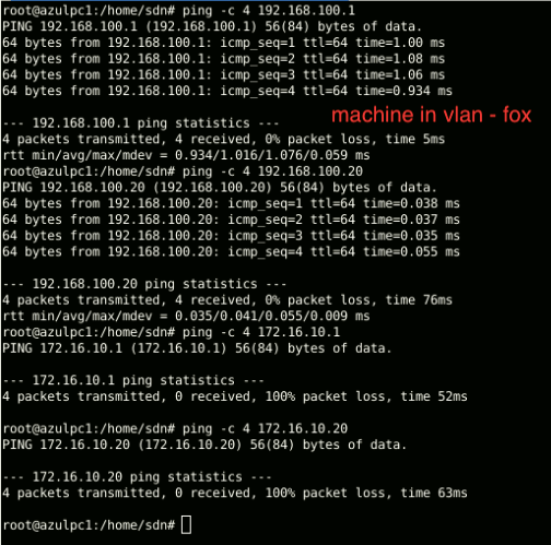

12-15-2020 11:20 AM
Here are some images showing the ping made by the switch, an image showing a machine on the vlan fox pinging the entire network and another image showing a machine on the vlan wolf pinging the entire network. Thank you!

12-15-2020 05:51 AM
Hmm,
can you do a ping on the switch “ping 172.16.10.1 from 192.168.100.1” and “ping 192.168.100.1 from 172.16.10.1”, please.
