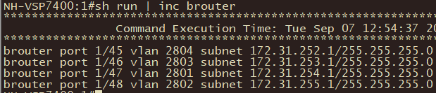

Looking back at some notes from when I labbed this up and I used brouter ports with 2 subnets and different VLANs on the brouter ports….both peers came up in that scenario.

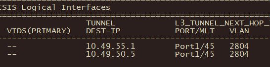

Also, when I run “show isis logical-interface” it shows the 2 tunnel interfaces, but lists the same physical port and vlan even though they are configured differently.
So the down site should be port 1/48 vlan 2802. That brouter is 172.31.255.3/24. I can’t figure out what it is looking out the wrong port.

That makes sense. What I ran into on Friday is that with 2 test sites, only 1 of the 2 will be up. They are on different brouter ports in the same VRF (not the GRT). Each link is a different 172.x.x.x/24 subnet with routes to the peer’s loopback. The VLAN on the brouter ports is different for each link. Feels so close to being done!
One example given to me uses VLAN interfaces instead of brouter ports, but to me that should not make a big difference as long as the devices have routes to the tunnel destination.
