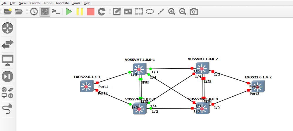

Here is a quick snapshot of the network:
