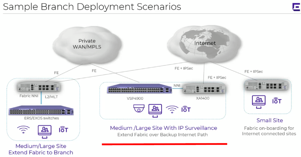

I am trying to achieve the scenario on the very left in the following screenshot:

If I have the necessary hardware resources at the remote branch site, then would you say that right now it is a better solution to implement the scenario shown in the middle of the screenshot below?
This way, at the remote branch I will have one VSP connected to one ISP circuit and another VSP connected to another ISP circuit, with an ISIS adjacency between the VSPs. If either of the WAN circuits was to go down, I would be relying on Fabric Connect to select the available path to the main site.
Thanks again for the valuable input!
