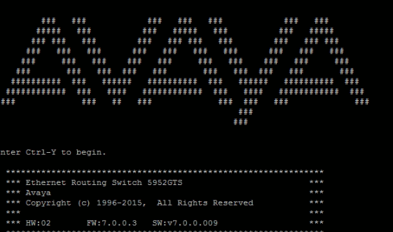

Hi all,
it is possible to upgrade the firmware directly into the latest FW 7.8 version or need to have a staged upgrade?  eg:
  1. Version 7.0 - 7.4 - Avaya
  2. Version 7.5 - 7.8 - From Extreme
kindly advise
