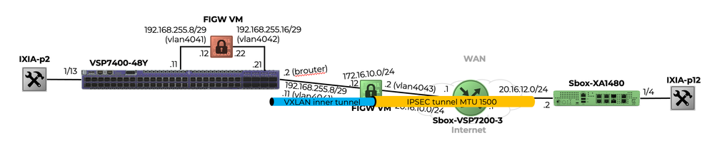

IPSEC is always over L3. MACSEC is over L2.
Here a possible setup

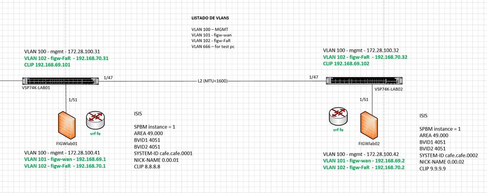

I´ll try better, this is my working environment (VXLAN+FRAGMENTATION) , My deploy is L2 link with MTU less 1600 bytes between two FIGWs and it´s working fine:
Now I want to add IPSEC but I'm unable to add the necessary commands because there are exclusion with this config.
