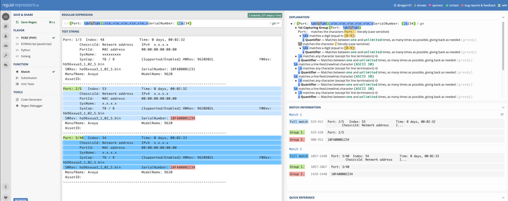

‎09-24-2020 09:30 PM
Roc156,
Try with this (qick and dirty) regex: (Port: \d+\/\d+).+\n.+\n.+\n.+\n.+\n.+SerialNumber: (.+1234)
Playing on https://regex101.com/
As here:
Catching the different occurrences of the Group1 will give the portids
Mig
