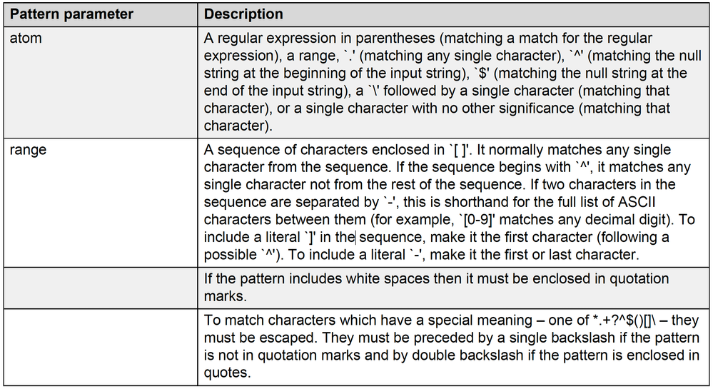

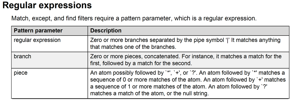

09-25-2020 08:59 AM
Roc156, Dilraj,
ERS is running on VxWorks with a limited support on regex expressions.
We cannot match the standard “\n” so the dirty solution I have is the following regex:
sh lldp neighbor med inventory | match "(Port: .+\/.+).+|SerialNumber: .+1234"
Regards
Mig

09-25-2020 07:08 AM
Hi Miguel,
I didn’t test this on EXOS since the request from
4926GTS-PWR+#show lldp neighbor med inventory | ?
Pipe Filter
count Count lines of output
except Ignore lines of output matching a regular expression
find Begin with the line that matches a regular expression
head Display only the first few lines of output
match Only show output lines matching a regular expression
no-more Disable pagination for the current command
tail Display only the last few lines of output
Notice here, it says “regular expression” at the end of except, find and match option.
Regards,
DILRAJ
