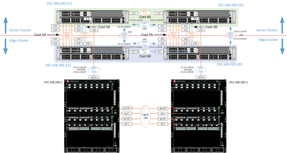

Have been told that it is quite routine to redistribute OSPF routes into ISIS and visa versa. In my topology OSPF is used as routes are exchanged with external firewalls.
Initially my thoughts where that I just needed to redistribute ISIS into OSPF, it doesn’t need to be the other way around. The reason for this was that each router in the topology will be running OSPF, so all routes and known paths would be shared.
Recently this changed a little, in that the network / fabric is expanding and there isn’t necessarily a need to run OSPF on these VSP’s, so should all routes be distributed into ISIS then the other fabric nodes will automatically be aware of the rest of the network.
Equally I come into a situation where the routing was not quite optimised, and OSPF was not able to reach certain nodes but ISIS could, so having the redistribution in both directions in place would have allowed connectivity to continue.
So think this gives a couple of good reasons as to why redistributing in both directions OSPF → ISIS and and ISIS → OSPF is a good idea.
Issue is, how do a do this safely without creating a routing loop?
Here is an overview of my topology:
The configuration on each of the VSPs currently looks like this:

exitAs you can see I am just redistributing in one direction ISIS → OSPF. Equally I am redistributing directly attached subnets into OSPF and ISIS.
Really appreciate some advise and examples.

Hi Martin,
I’m not in favour to redistribute OSPF -> ISIS and ISIS->OSPF.
This could lead to L3 loops or you need to put in place too complex route maps to avoid it.
I would:
 I don’t have a global vision of the setup and configs but here you can see that advertising only the default route from ISIS into OSPF is enough for the OSPF network be able to reach anything into the Fabric.
With this:
Regards
Mig
