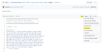

Just a note, for those trying to download the Python script from Github, you need to right-click on the "Raw" button and "Save Link As...":
