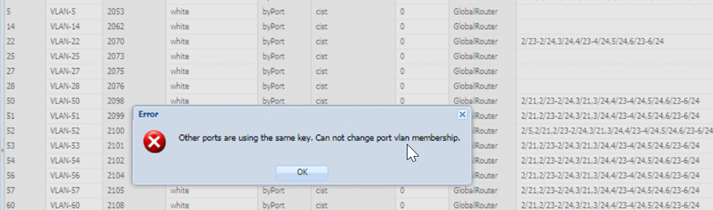

Another issue is If I try and use the EDM as per below to remove a port from a VLAN I get the following error:
Sure there is a perfect explanation just seems odd on the surface.

Regarding the edge switches I was hoping that you had something that supported Fabric Attach such as EXOS or ERS. That would make it much easier for you. Unfortunately EOS does not have FA.
There was a time where you had to disable the LACP LAG to add VLANs but that was changed several years back (for good reason). You should be able to do so using the above commands. Note that when you save to config you will see the ports in a ‘vlan member add’ command. Also note that if you have any ports that are members of the LACP LAG but not up you may need to add them manually while down - they must match in order to be dynamically added to the LAG when they come up.
