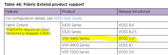

I might have found an answer...
On VSP4450, with ONA, the config is somewhat different...
VSP4450-1:1#% cfg||tunn

It should all be in the manuals.
