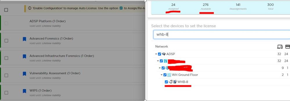

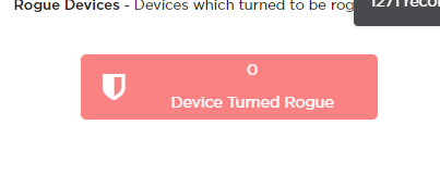

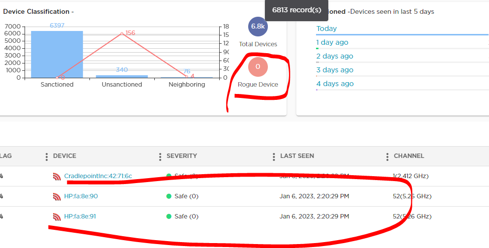

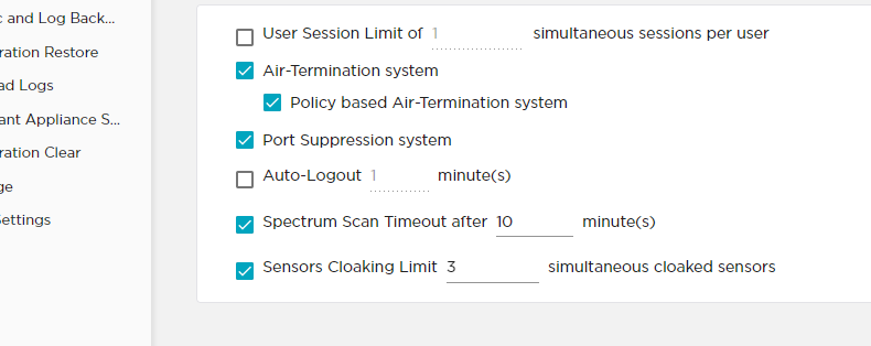

I'm using a Netgear nighthaw wireless router to test airdefense Rogue detection and termination. I get the alarms we configure like unsanctioned bss using sanction bss and sanctioned wpa3 ssid name same as unsanctioned wpa2 bss and a lot other alarms but i never get the alarm of a rogue AP. I verified the AP has the WIPS license and that air termination system and policy based air-termination system options are checked.

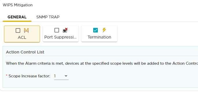

I have some filters on the alarm action manager rule i created that's supposed to trigger airtermination. I'm almost certain that the filters are going be wrong but I think I should at least see this AP showing as a BSS and a Rogue AP?

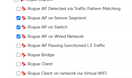

right now i have these alarms configured in one of my alarm action manager rules:
unsanctioned bss using sanctioned ssid
rogue ap on sensor segment
rogue ap on switch
rogue ap on wired network
So my question is, can or should I remove all the other alarms and leave only the two that the netgear Ap generated for it to work on different vlan/network segments?
