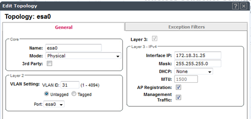

I have a strange Problem:
On my V2110 Controller I use the esa0 Interface for the AP registration.
c52797da7dee4ef18219e6a23e5af917_RackMultipart20140114-1231-118ep4x-2014-01-1413_12_00-EWC-EnterasysWirelessAssistant-WirelessController_inline.png
If my AP's (Siemens AP2610) are in the same subnet, everythings works

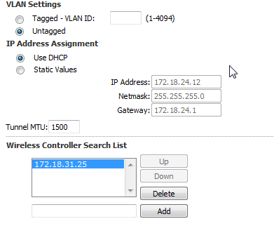

fine. Now i want to bring one AP to a remote subnet, the registration fails, but the controller knows the new AP IP address (172.18.24.0/24). I can telnet the AP and ping the controller and the controller can ping the AP (no firewall between them). There is also a DNS Record "controller.domain.name" pointing to the 172.18.31.25
c52797da7dee4ef18219e6a23e5af917_RackMultipart20140114-32389-1hidb4q-2014-01-1413_26_01-EWC-EnterasysWirelessAssistant-WirelessAPs_inline.png
So there must be a communication between AP and EWC, because i can ping and enable/disble Telnet. But the AP is not shown in the active AP list.
I don't know where I misconfigured it.

I have same problem and adding static routes solves the problem.

Damn,
it was a routing problem.
I added static route to the remote Subnet via the esa0 subnet gateway and upon next boot it the AP is marked as online
Thanks for your support!!!

for b) could it be that your admin interface is enabled and there is a default route entry on this port.
So that the AP try to connect to the ESA0 port but the return packet is routed out via the admin interface.
If that is the case could you shutdown the admin interface for the test?
