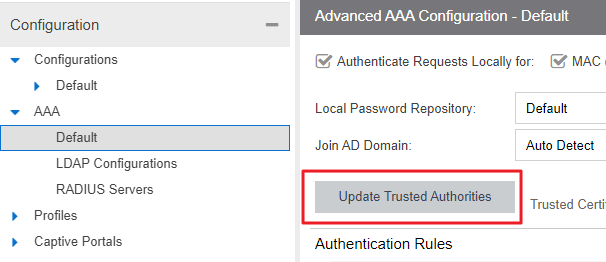

3- Load the CA cert on the ā€œUpdate Trusted Authoritiesā€ under AAA settings in EAC.

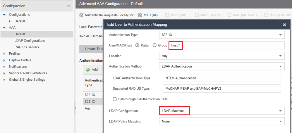

5- Setup LDAP on EAC to authenticate your machines/computers, make sure you set it up with AD machine default values as per following:
6- Configure AAA rule as per below and make sure you have correct match pattern for host and LDAP settings selected, usually it is host/* or *@* depending on how your directory service is setup.
7- Finally, create an appropriate rule to address the cert based authentication, you either set it to a more generic auth type 802.1x or be more specific and set it to 802.1x EAP-TLS.
