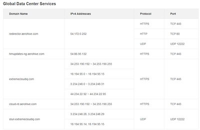

There are no known compatibility problems. What I suspect is happening is that there are ACLs or a firewall somewhere between the AP and the ExtremeCloud IQ that is preventing the connection.
Ensure that when a device is connected to the switch that these are available and not blocked.
