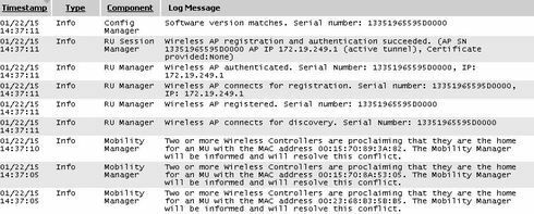

The customer reports, that WLAN is not working. When we check the WLC, we see that the AP is connected, but the tunnel is not working properly and the radio interfaces are not sending out.
Earlier we could resolve the issue by setting/releasing admin mode, rebooting a few times, on/off transmit power, request channels -> after doing this irregularly for a few times, the AP's came up again. But now even this won't work anymore for two of them.
The AP is available via SSH, it's able to ping the WLC's and vice-versa. It's also correctly authenticating on the WLC according to the log-messages, but the radio simply won't go up.
