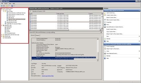

Like Ron stated you would want to review the NPS Event log to see why the client failed to connect. There is usually a reason code.
Here is an example:

There is only one place where I look in such case... the NPS log.
The controller is only the message forwarder between the wireless client and the NPS and has no clue what this 2 talk to each other.
