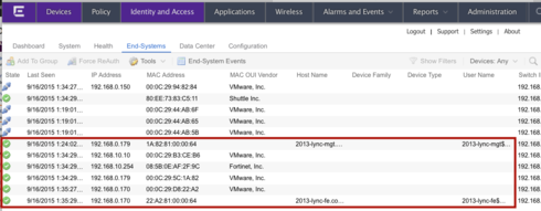

Hi Daniel,
we are using authentication not only for security reasons mostly the visibility effect is more important!
Visibility means that through RADIUS Authentication i know immediately (Netsight DB) where which device (server and any other system) is connected. From that point of view it will be very useful that netlogin and sharing will not exclude each other.
