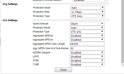

If you still have the high delay set the test AP to the following settings... in short disable all the fency stuff..
