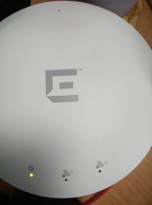

Have an AP3805i.
Install guide say that power LED can be red or green
But in my AP3805i only power LED is yellow and steady
790e816ca1684f82991fa13779e616d0_RackMultipart20161220-36055-1jvw1dz-IMG_20161220_094249_inline.jpg
Any ideas?
Thank you!

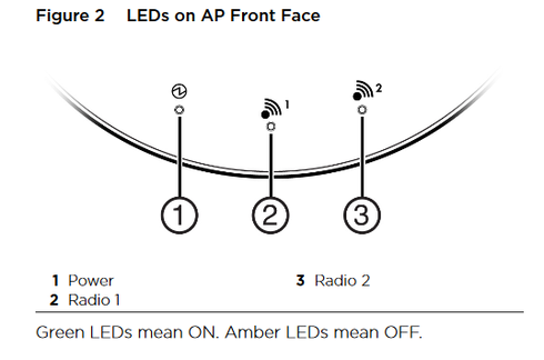

Hello Alexandr,
I think there's an typo on the install guide and "On Red" should be "On Amber".
Quick install guide implies it has Green and Amber colors only on the led.

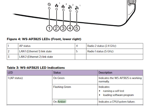

Install guide for AP3825 says amber means a failure as below.
117639c9f8574431aef61c21411beaed_RackMultipart20161220-58747-5pla44-3825i_led_inline.png
So how about open a case and I think this will probably be subjected to an RMA.
