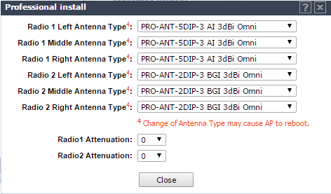

"Radio Attenuation" value we have tu put if we use antenna with some cable or attenuator.
If we connect antennas directly to AP - then value have to be "0".
Right?
Thank you!
The values should be dB but to tell the thru I've never used it as I've never installed ext. antennas with long antenna cables.
I normaly just search for the correct antenna in the pull down menu and leave the attenuation on 0.
Here one of my AP3825e with the little antennas connected....
ba977f226e934c67875083c0abd60812_RackMultipart20151022-14964-188lmvf-AP_antenna_inline.png
So, in "Professional install" -> "Attenuation" we type dBi or dB value?
