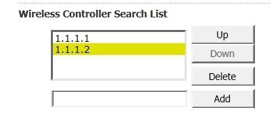

Did you configure "Wireless Controller Search List" in all APs as below?
c03ff12befdc4232910e0e7a424a585c_RackMultipart20161205-47329-5335-20161205_173504_inline.jpg
Above configuration would be recommended in HA environment. Please ensure that the IP address of primary controller should be located in upper side and bottom side for secondary controller.
