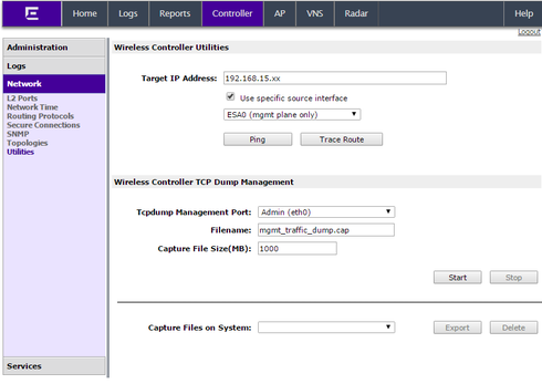

Could you please do a advanced ping from the controller GUI to the AP IP.
As per below screenshot put in the target IP = AP IP, checkmark "Use specific source interface", choose the interface that is used to register the APs in the pull down menu.
Please let us know the results.
