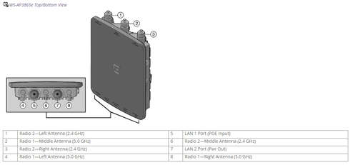

i have AP3865e and 03 antenna DS02360N3, i want use 06 antenna DS02360N3 then power (dbm) and gain (dbi) of AP3865e is how much?

With that little input my assumption is that the antennas are not installed correctly.
1) Do you use WLAN on the 2.4GHz OR 5GHz band on this AP OR on both frequencies/radios.
2) From the below picture - which antenna connectors do you use right now, please tell us the number
51a49260f225444eaba85e0081c1f11f_RackMultipart20170327-53398-1kijwm0-AP3865e_antenna_connector_inline.png

AP 3865e platform support only 3Ɨ3:3,3 spacial streams at time.
The antennae has 2dbm gain.
Please let me know your requirement for installing 6 antennae.
Proper sight survey has to be made before deciding the power settings.
However I would recommended the minimal 6dbm power initially and further tweek based on the spectrum analysis.
Regards
Rajesh J
Hi Rajesh,
I am currently using a AP3865e with 3 antennas DS02360N3, but I see wave is very weak (I have put AP on the 5 meter high column, column foot only 1 bar wave), can I improve if 3 more antennas are added?
and with 6 antennas this , the total gain is still only 2dbi at 2.4GHz ?
thanks!
