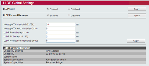

‎11-24-2016 05:04 PM
Hey Bastian,
here the switch settings and I've it also enabled on the AP...
‎11-24-2016 05:01 PM
Ron,
can you check the LLDP PoE option is enabled on the switch.
regards
Bastian
regards
Bastian
