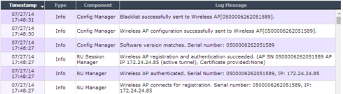

Please do the following....
- set the log level to informational in the GUI > Controller > Logs > Logs Configuration > Wireless Controller Log Level:
- disconnect the AP from the port/power
- reconncet the AP
- look into the log, is the last message that you get "Blacklist successfully sent..." like in the screenshot below.
If not please post a screenshot
