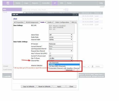

the channel config is a per AP and per Radio configuration (see picture below).
DFS to avoide Radar signals is only relevant in 5 GHz.
You can select for example "All Non-DFS-Channel" or a "Custom" plan. Push the "Configure" button after choosing "Custom"!!! to select the appropriate channels.
abb588a19cb94d3289ea7a86027ca26d_RackMultipart20170612-53609-6t9lmd-Channelplan_inline.jpg
